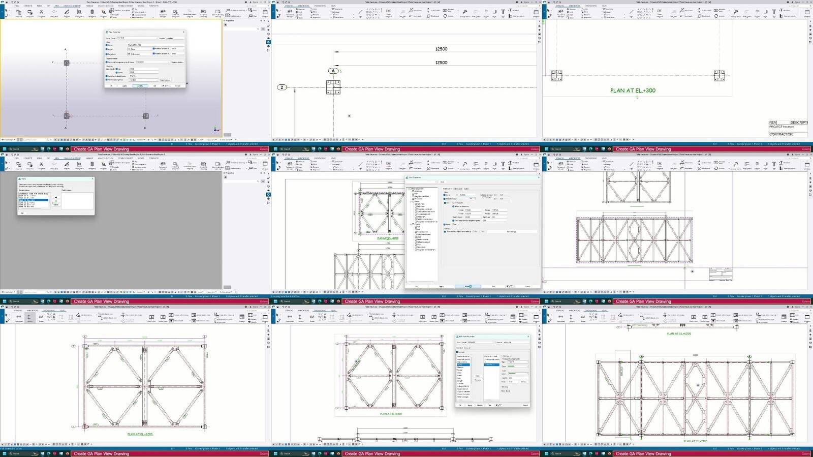

Tekla Structures Advanced Oil & Gas Pipe Rack Module and Stick Built Project Based Training for All Level Students.
What you'll learn
To learn Grid and View Creation
To learn Beams and Column Creation
To learn Beam to Beam Welded Connection with Edge Preparation
To learn Bracing and Gusset Connection Creation
To learn Column to Beam and Beam to Beam Bolt connection
To learn General Arrangement, Assembly and Single Part Drawing Creation
To learn Report Creation
To learn NC File Creation

Tekla Structures world No:1 Building Information Modeling (BIM) Software. Tekla Structures used to create steel, reinforced concrete design and detail engineering activities for various industry. You can Create accurate 3D Model with all engineering data it can built any kind of structures in this Software.You can get knowledge to create oil and gas Industrial steel pipe rack structure project in this CourseYou will learn to create grid and its viewsYou will learn to create beam in various levelYou will learn to create beam to beam welded connection with edge preparation for butt weld and bolted connectionsYou will learn to create columnYou will learn to create base plate with anchor boltYou will learn to create column and beam splice connectionYou will learn to create pipe bracing and it's gusset plate connectionYou will learn to create pad eye designYou will learn to create column to beam stub connectionsYou will learn to create clash check and resolve the clashYou will learn to create numberingYou will learn to create general arrangement drawing (GA) and detailing You will learn to create assembly drawing and detailingYou will learn to create single part drawing and detailingYou will learn to create revision and print drawingYou will learn to create report (Assembly List, Part List, Assembly Part List, Bolt List, Shipping List, Material Excel List)You will learn to convert xsr file to xls file in reportYou will learn to create NC file for plate and beamYou will learn to work with profile catalog, material catalog and bolt catalogYou will learn to create accurate output files for fabrications and ExecutionAfter this course you will get knowledge to work Any Steel IndustryDon't wait, Let's Start your good Steps your lifeBest of Luck

Section 4: General Arrangement Drawing (Detailing)
Lecture 43 Create 3D GA Drawing
Lecture 44 Create GA Plan View Drawing
Lecture 45 Create GA Grid Elevation View Drawing
Lecture 46 Create Detail and Sectional View
Lecture 47 Change Drawing Title and Project Information
Lecture 48 Add Revision to GA Drawing
Lecture 49 Print GA Drawing
