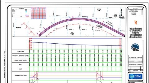

NEW UPDATESBasics of Swept path analysis with Autodesk Vehicle trackingSample Offsets and Offset Profiles in Civil 3DIn this course, you will learn how to design a road with AutoCAD Civil 3D software from the basics. We will be doing this as a tutorial project from start to end. The software version we use is Autodesk Civil 3D 2020. Any Civil 3D version newer than Civil 3D 2018 can be used to follow this course.Before doing this course it would be an advantage if you have some insight into AutoCAD basics. This course is created more related to a Highway Engineering background. So the Engineers or Engineering students would find this very useful to start their career as a Highway Design Engineer.The project objective is to connect a City to an Industrial zone with a two-lane two-way road with a design speed of 50km/h. We will be using AASHTO 2011 design guidelines as the design reference when doing the designs. The following list shows the aspects we are covering throughout this course.1. Introduction - Road Design With AutoCAD Civil 3D2. Understanding AutoCAD Civil 3D Interface3. Understand Civil 3D Object Styles, Label styles, and Label Sets4. Open New Drawing with Civil 3D5. Import Points into Civil 3D6. Set External Reference for AutoCAD drawings7. Create Surface from Points8. Add Surface Boundary to Civil 3D Surface9. Add Breaklines to Surface to Civil 3D Surface10. Export Civil 3D Surface to LandXML11. Open New Civil 3D Template drawing and Import LandXML Surface into Civil 3D12. Create Alignment in Civil 3D13. Create Road Layout in drawing14. Create Surface Profile and Profile View 15. Add Superelevation to Alignment16. Create Final Road Profile17. Set the data bands for Profile View18. Create Assemblies19. Create Corridor20. Target Mapping21. Split Corridor22. Create Corridor Surfaces23. Create Sample Lines and Section Views24. Calculate Material Quantities
