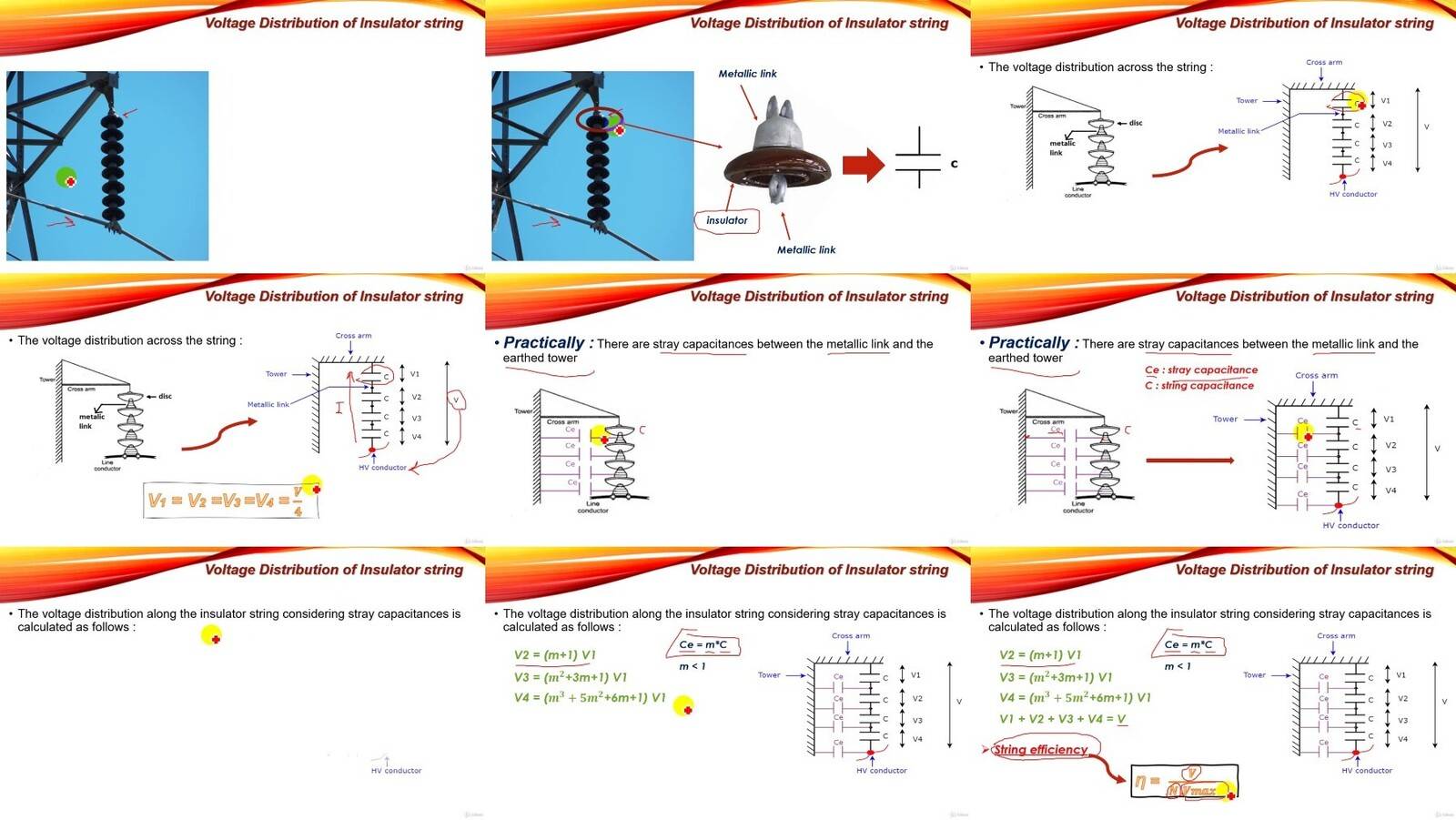

Understand the function of overhead lines insulators
Understand the main features of overhead lines insulators

Voltage distribution across the insulator string
Improvement of string efficiency
learn the importance of using guard rings with the insulator
